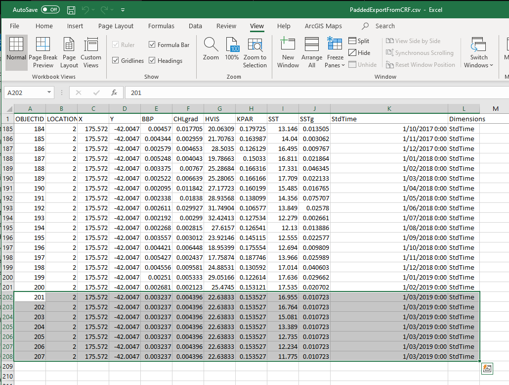

You can see what happens in the screenshot below, I’ve highlighted the rows where the error occurs:
Column I (SST) is the dataset for which the timeline has the most time slices – so that gets exported correctly – all the values are unique and differ (as they vary over time). All the other preceding (A-H) and succeeding (J) product columns and also the “StdTime” column (K) have repeated values beginning in line 201. The reason for that is that we don’t actually have the timeslices 1/03/2019 0:00 ff. for those parameters.
It appears that the Multidimensional Export from the Transposed CRF just pads the columns with whatever value is the last available (line 201).
Therefore, if you look at the last 5 values for SST and the adjacent KPAR, SST is exported correctly - and KPAR is just 'filled in' with the last available 'true' raster value.
Erroneous Export Values from MD Transposed CRF

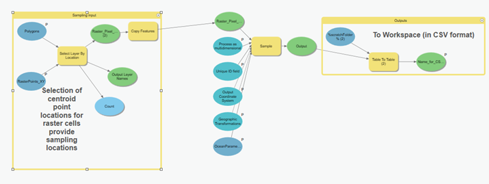

This is how my tool is built. To improve sampling speed, it uses a point feature class where the points are the center points of a raster cell. The first step in the model allows a user to make a selection of points on the screen - those are the raster cell locations which will sampled:
Sample Tool Setup

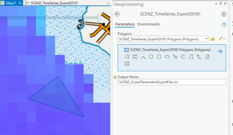

Export using a Polygon drawn on screen
All of that works very well – particularly when the variables have the same length in the StdTime dimension (as they do in the Web Application referenced above).
When they have different lengths, the tool erroneously writes values from the ‘adjacent’ Variable column into those columns where the Time Dimension is shorter (See the screenshot from Excel above).
