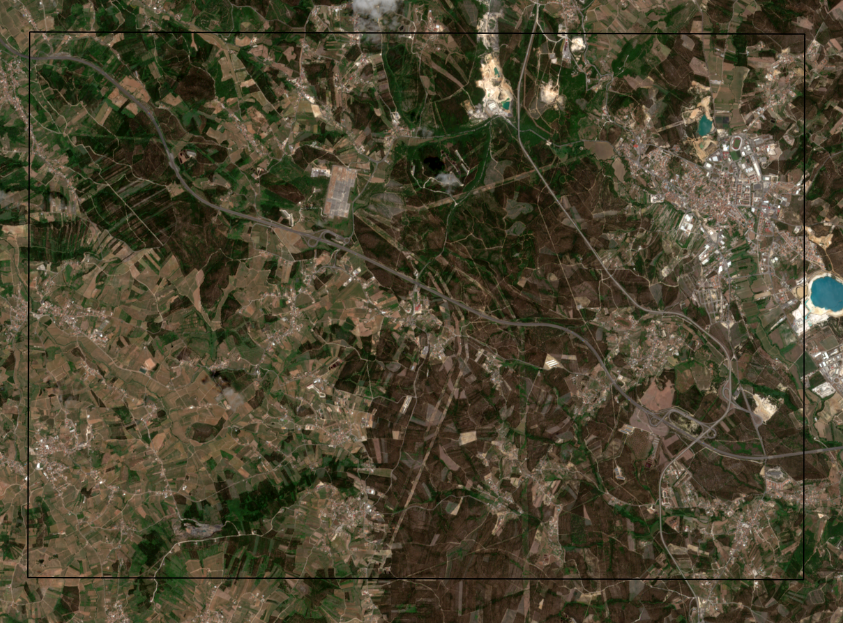

Starting point:

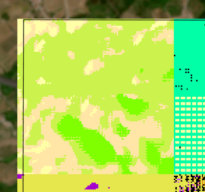

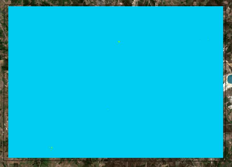

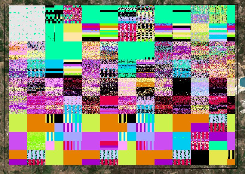

 Scenario 1 - GPU - Mosaicked Image / Batch size 4/GPU:
 Scenario 1 - CPU - Mosaicked Image / Batch size 4/CPU:
 For scenario 2 same results, GPU and CPU.
For the GPU case I don't have a clue what the issue is. I've ArcGIS Pro Advanced 2.7.1, Image Analyst ext, Deep Learning Framework (with all the requirements, including visual studio). My GPU is RTX 3070 8 Gb who I consider has enough power to do the math. No errors or warnings are presented in the inference processing.
For the CPU the results are clearly not adequate. The test area is about 145.6716km². Most of the classification is Inland Waters, and that doesn't make any sense has you see above in the sentinel 2 scene. I know the model is Unet and should be using GPU, but nevertheless I thought it could be SRS (WGS 1984 UTM Zone 29N) the issue.

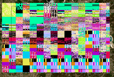

I tested again, scenario 2, the below image is GPU processing
 CPU mode was about the same.
I understand that the Pytorch version in use in ArcGIS Pro supports only CUDA 10.2 and no CUDA 11.x GPU's. I've seen around the threads issues alike, with different graphic cards, Touring and Pascal, and this type of issue are happening in pixel classification using deep learning.

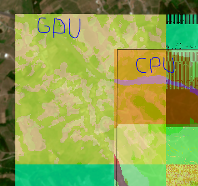

@Anonymous User one thing, not all the processing was wrong. See this upper left corner in the image:
 Could be the tiles? Any thoughts on this?
Thanks
TiagoCarvalho1979

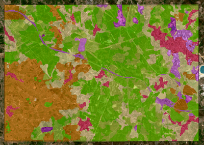

I also done a CPU based inference. The results are less granular, although I've delimited the inference based on a polygon of a pre-defined AoI. The results:
 Now for the upper left limit in my previous post, compare btw GPU and CPU processing:

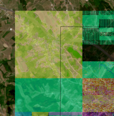

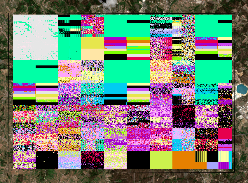

 I tested with batch size = 1. The processing is below:
 Again upper left corner did work:
 My issue related with CPU processing is that the granularity of the processing is lesser. See bellow the same are by CPU inference:
 classification is not the same.

Hi all,

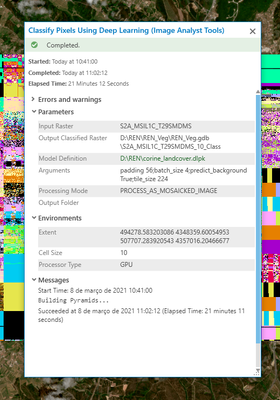

new feedback for the discussion. What happens is something like this:
 so in the example above the GPU is working. I was identifying if the problem was regarding to the pre-defined extent of the processing. So looking at the CUDA chart the GPU is processing without any problems of memory neither GPU. Then a peak happens in CUDA and the processing breaks with the above results showing. This is a strange behaviour. I use my GPU for 3D rendering and analysis and nothing like this happens, and I have all drivers update.
Any comments on this?
