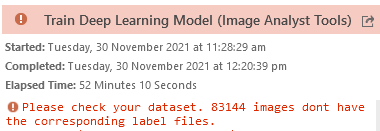

I tried a export with no Feature Tiles option. However, they are seems ignored during the training process.
So I think the answer for Q1 and Q2 is no?
Q3. Thank you for your suggestion. I tried and it solved my problem
