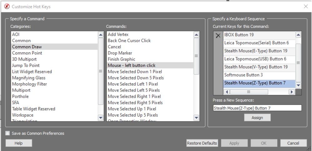

Actually, it would be nice if system mouse right and system mouse left could be assigned to any button of the Stealth Mouse.
Markus Wortmann and Samuel Küng from Scherrer Engineers in Switzerland use the Stealth Mouse S3 with SocetGXP. There it is possible to assign system mouse left (or right) to any key of the mouse:
Markus is left-handed and Samuel right-handed. Therefore they use different buttons for the same tasks.
