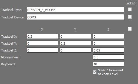

In Socet GXP(R) (another software for photogrammetric evaluations) this is already possible in the settings. I can set the mouse speed separately for each dimension (X, Y and Z) (see printscreen). Socet GXP also has a setting that allows you to separate the system mouse from the 3D mouse. The speed of the system mouse is then set normally in Windows, while the 3D mouse is set in Socet GXP(R).
This should therefore not be a problem for the future implementation in ArcGIS Pro.
