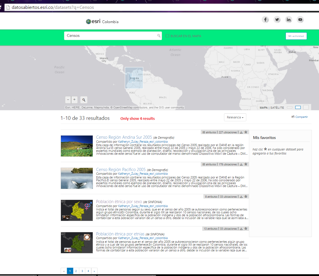

1) When i search for Censo tag , the site only return  in the display 4 results of 10. The other six elements  exists in the same AGOL group that the other features.

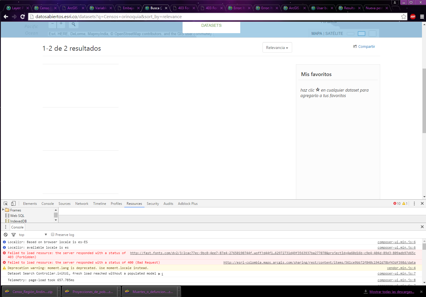

When i try search any feature (e.g. : Censo orinoquia )  of the 6 hidden in the above screenshot. The search return the results  but doesn´t show the description or downloads options.

Interesting.  When I first looked at the results I was able to see all 10.  But when I refreshed (i.e. change my screen size to full) I only saw the 4 you mentioned.     When going to the next page for 11-20 I see 10.
I used one of your other tags "Gobierno" and was able to see 10 on the first page.  Searched on "Censo" again, and only 4 or the 1-10 showed.  I'm sure you are getting the same issues, but thought I would test and verify as an outsider.  I am using Firefox 45.0.1.     I can't test this on our site since we don't currently have more than 10 items.
It's strange that it happens for that tag, and not the other.

If you search Censo Región Andina Sur 2005 in datosabiertos.esri.co  --> you could find it
but if you search Censo Region Orinoquia 2005 in datosabiertos.esri.co  --> you could find it but the result doesn´t show the description or downloads options (white display)
All this layers belong to Censos tag , if you search this tag the site don´t show all results.

I try a lot things  but don´t work.  I inspection (F12) the website and look the console code  and the messages make me think the open data site are look some features id of the AGOL content differents to the true feature id in the AGOL content
