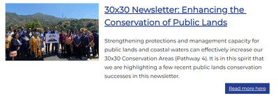

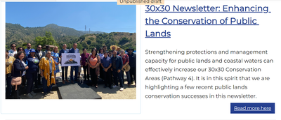

Image 1: Image & Text card SxS (but no option to edit image size)

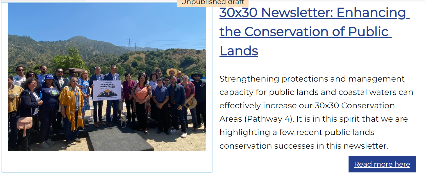

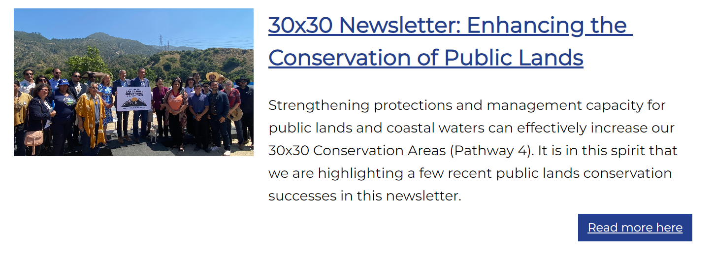

Image 2: Using html to display image in a float left style and text float right (but the image and text do not re-align vertically for smart phones/tablets)
Here is the code from the second option. I also found that if I add too much text, the text just runs off of this row/card and into other elements forcing me to put a space below.

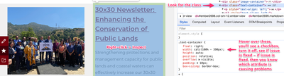

In our earlier conversation, we talked about how to simplify your code to find out what CSS element was causing the text to cut off and I recommended removing all the positioning attributes, as doing anything with top, bottom, left, right and absolute or fixed positioning is risky when you're a beginner and don't fully understand what the code is doing. I also recommended opening up Chrome Dev tools via right-click on an element > Inspect and then turning on and off the checkboxes. I also suggested wrapping any CSS you embed via <style> tags in a unique classname that could be set in Row Settings under CSS Class, so as to be less likely to interfere with the CSS classnames Hub uses to make our software. For a more detailed reply with pictures on how to do that, see my response here: https://community.esri.com/t5/arcgis-hub-questions/how-to-get-all-cards-in-a-text-box-to-dynamically...
Right click website element, select inspect from dropdown menu, and then within CSS properties start turning off attributes until the problem is identifiedRight click website element, select inspect from dropdown menu, and then within CSS properties start turning off attributes until the problem is identified
