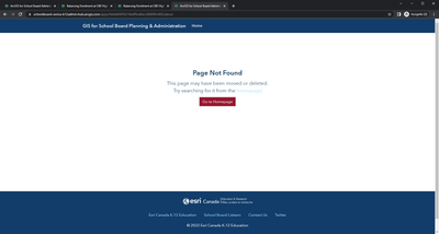

I have several Galleries in this Hub: https://schoolboard-esrica-k12admin.hub.arcgis.com/.
When trying to share the links to the items within the Galleries, the link redirects to Page Not Found. This happens when I copy and paste the URL as well as when using the Share button on the left menu.
In the attached screenshot, the direct URL (https://schoolboard-esrica-k12admin.hub.arcgis.com/apps/9afa065ff3b74ddf9cd8ec360890c483/explore) leads to Page Not Found. When using the Share button, the shortlink (https://arcg.is/1bPa4G) also leads to Page Not Found. This happens for every Gallery item.
How can I share the links to these Gallery items within the ArcGIS Hub?
Thanks!
SusieSaliola_EsriCanada
SOLVED: Link sharing works after sharing the items to the site's content group in ArcGIS Online OR adding existing items to the content library.
