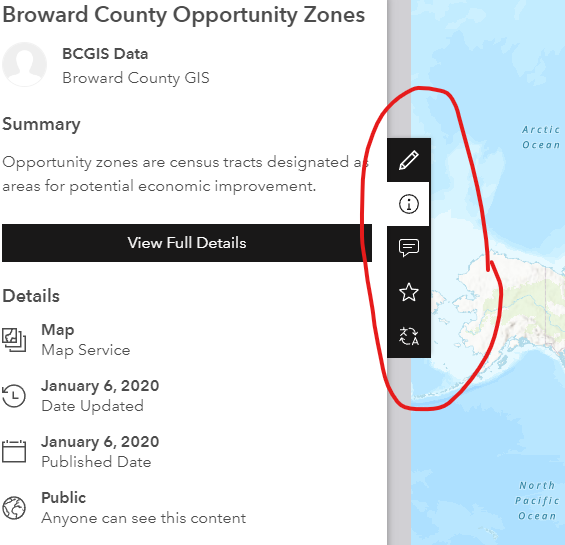

We are noticing that our map services are somewhat difficult to download off of our Open Data Hub Site. When we click on a map service to download, we have to go through a few extra steps to make the download button appear. Below find the options first presented off a map image:

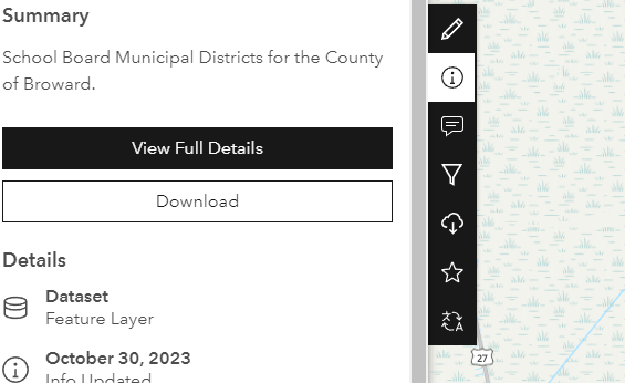

We contacted Esri support and consulted with our Esri team and we were told we had to republish all our map image services to feature services. Note below all options made readily available for feature services:
