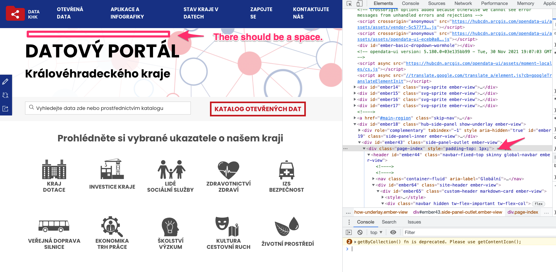

Hi folks!
We're hitting this kind of issue you can see on the video.

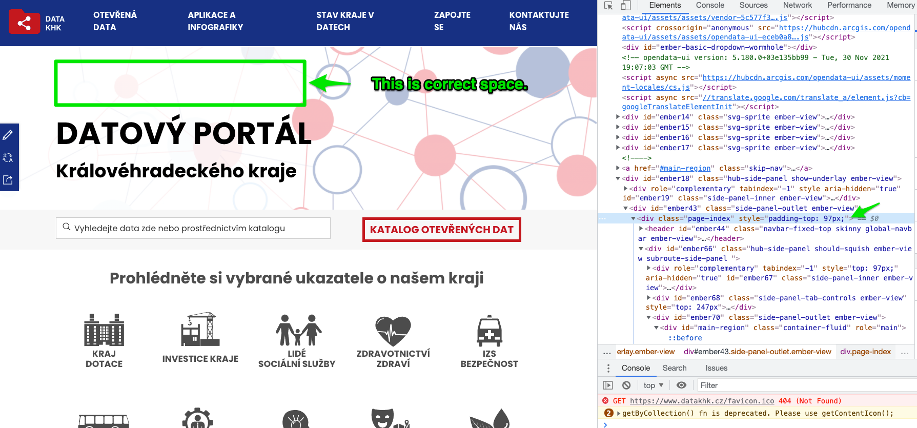

There is a header with a headline and if you are using Firefox (sometime in other browsers too) you can see there is no space at the first load. The space is showed after refresh.
Underlying page: https://www.datakhk.cz
(view in My Videos)
From my point of view there is a bug in calculation of page-index element.
This is correct behaviour.

Hello @milansulc,
After digging into this, we believe there is some element on your site that is causing a delay in page loading and that delay then affects the page-index padding as a result of a calculation we do to compensate for header height. This is a bug and I will open an issue to get it addressed with the team. I will let you know when it's been resolved. Apologies for the inconvenience you are experiencing.
