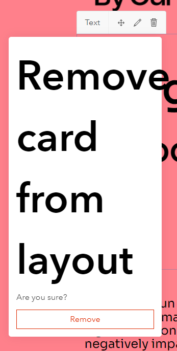

The text which pops up when I try to format or delete items in my Hub layout is really large:

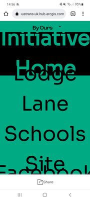

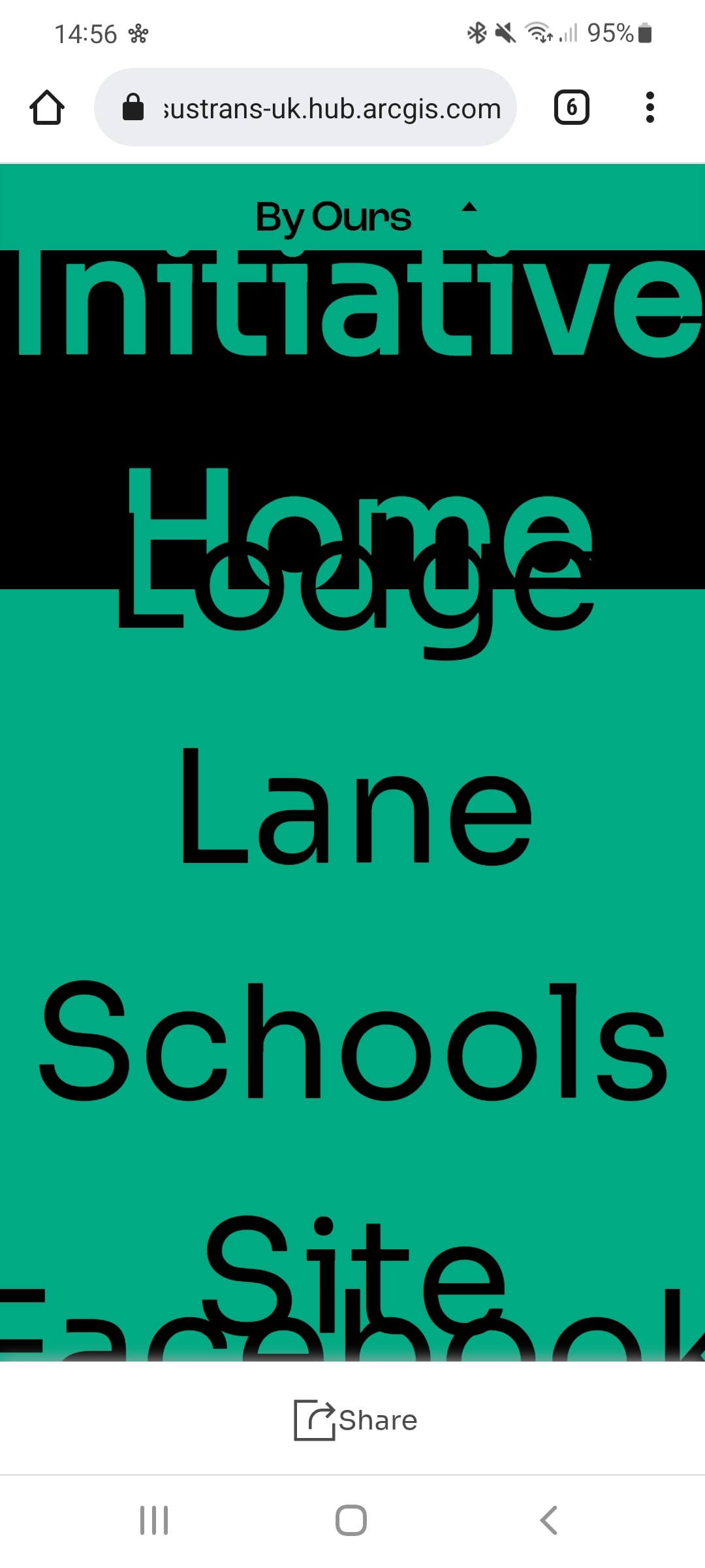

I think the same issue is affecting the main site menu for mobile users:
I have applied a custom font to the site, and set font sizes for headers in the HTML of a text box as below:
<style>
header{
font-size: 60pt;
color: #000000;
h1{
font-size: 48pt;
color: #000000;
h2{
font-size: 36pt
color: #000000;
h3{
font-size: 24pt
color: #000000;
h4{
font-size: 16pt
color: #000000;
ul{
font-size: 16pt
color: #000000;
li{
font-size: 16pt
color: #000000;
</style>
Could this be causing the issue? The large pop-ups as I'm editing the sites aren't a huge concern, but the menu links for mobile users really need fixing.

Hello,
Typically, we discourage use of generic CSS selectors in custom CSS as it can have unwanted side-effects on the actual layout application, which also uses headings, ul, and li elements and might be getting caught up in a cascade effect. Ideally, you'd want to wrap any Text Cards with custom styles in a unique class (you can do this in row settings) and then you'd prepend the row class as a unique selector in front of your generic selectors. Maybe you could give that a try on one of your affected sections?

Hello,
That's the ticket! I was unknowingly making my own life difficult.
