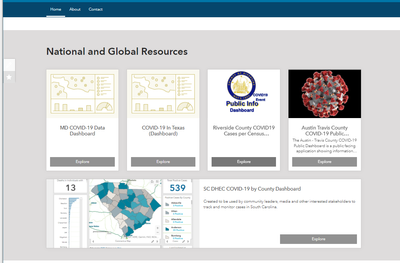

Secondly - in Gallery if you have an odd number of items, like viewers, let's say three or five.. it stretches the bottom one very widely. It looks very bad. It also resizes the thumbnail image, and cuts it off. It does not look good. Is there a CSS workaround Esri could provide to stop the resizing?

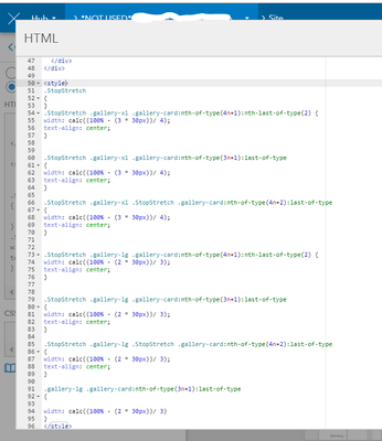

I created a class on the Gallery card called StopStretch, in the box where you can add a custom style tag.  I then used last-of-type pseudo selectors to get the last two and prevent stretching, by using the same Calc() calculations as the existing bootstrap classes. Complete <style> block is below, as entered inline to the Footer:
<style>
.StopStretch
.StopStretch .gallery-xl .gallery-card:nth-of-type(4n+1):nth-last-of-type(2) {
width: calc((100% - (3 * 30px))/ 4);
text-align: center;
.StopStretch .gallery-xl .gallery-card:nth-of-type(3n+1):last-of-type
text-align: center;
.StopStretch .gallery-xl .StopStretch .gallery-card:nth-of-type(4n+2):last-of-type
text-align: center;
.StopStretch .gallery-lg .gallery-card:nth-of-type(4n+1):nth-last-of-type(2) {
width: calc((100% - (2 * 30px))/ 3);
text-align: center;
.StopStretch .gallery-lg .gallery-card:nth-of-type(3n+1):last-of-type
text-align: center;
.StopStretch .gallery-lg .StopStretch .gallery-card:nth-of-type(4n+2):last-of-type
text-align: center;

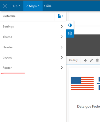

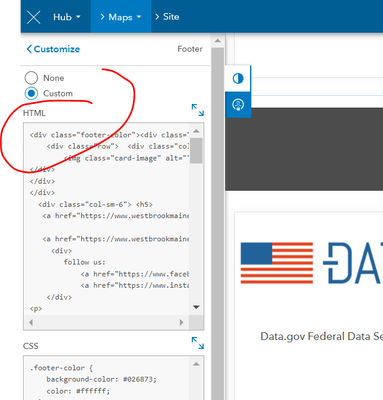

@JayJohnsonWashoeCounty  Here it is - you go in to Footer then go in to HTML:
For some reason it does not work in CSS only in <style> tags in HTML.

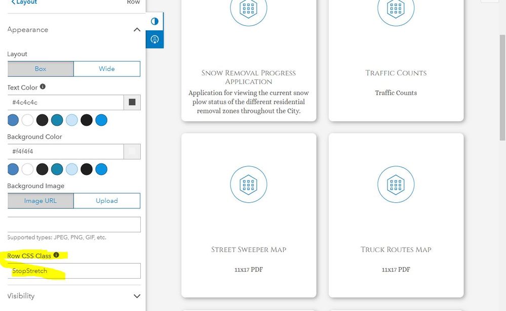

BobFolsom1
Jay I ran into the same problem I got closer still not a 100 percent but I went to the Row the gallery was embedded in and added StopStretch to the CSS line their and it workedCapture.JPGCapture.JPG
