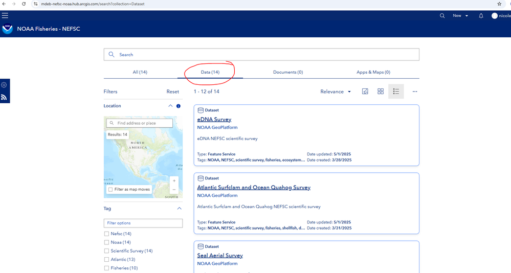

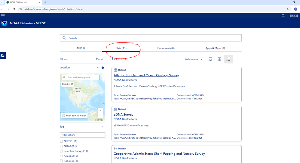

I have a Data Hub that is publicly accessible (https://mdeb-nefsc-noaa.hub.arcgis.com ) and includes 14 feature services in the Data Catalog. The feature services are all public and they are all part of a public group that populates the Data Catalog for the Hub. All feature services display in the catalog when I am logged into my AGOL account. However, when I log out to view the Hub as the public would, there are only 11 feature services. I cannot find any reason why the 3 missing feature services would not display in the catalog (again, they are shared with the public and part of the public group that populates the hub catalog).
Screenshots below. Thanks for any insight.

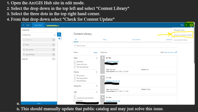

We just had a similar issue... after talking with an ESRI rep, we followed these instructions they gave us. It took a couple of hours to register, but it eventually worked. Hope it works for you!
