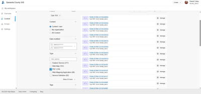

In the hub workspace, I do not see the 1,327 pdf files as part of the 'Content':

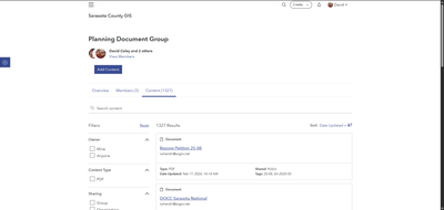

I do however see the pdf content when I toggle down to the Groups:
so as you can see here, this Group which participates in the Open Data site contains 1,327 pdf documents thus far, yet no longer shows this content in the Open Data Site....
