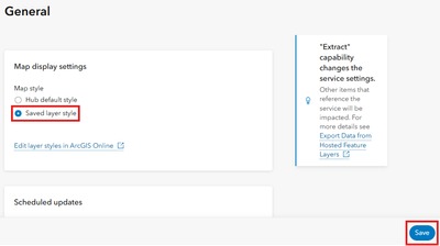

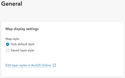

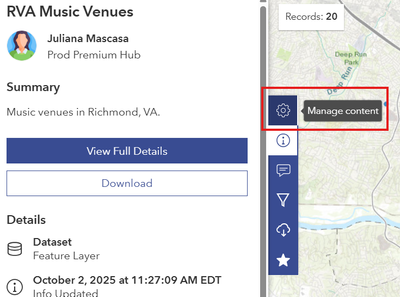

Thank you for your post,  @StephenHallett - we appreciate the feedback. I've pasted the steps that enable you to use a layer's custom style in Hub below. If you give this a try and are still experiencing issues, we recommend you log a defect with Esri Support Services, and we'll dig into it more deeply.
  1. From your dataset’s explore page, select the Manage content button to navigate to workspace.
  2. From here, select Settings > General.
  3. You’ll now see a Map display settings section that allows you to toggle between the Hub default style and the Saved layer style.
  4. back in the workspace (General pane), when you select Saved layer map style, select Save, and return to the layer’s explore view in Hub, you’ll see the updated style.
