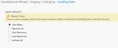

I have values for each data point for three separate years (in other words, there are three distinct values for every unique coordinate location sampled) and have been running Universal Kriging through the GeoStats Wizard and selected to use all data points as they represent unique nitrogen values (see screen shot).
