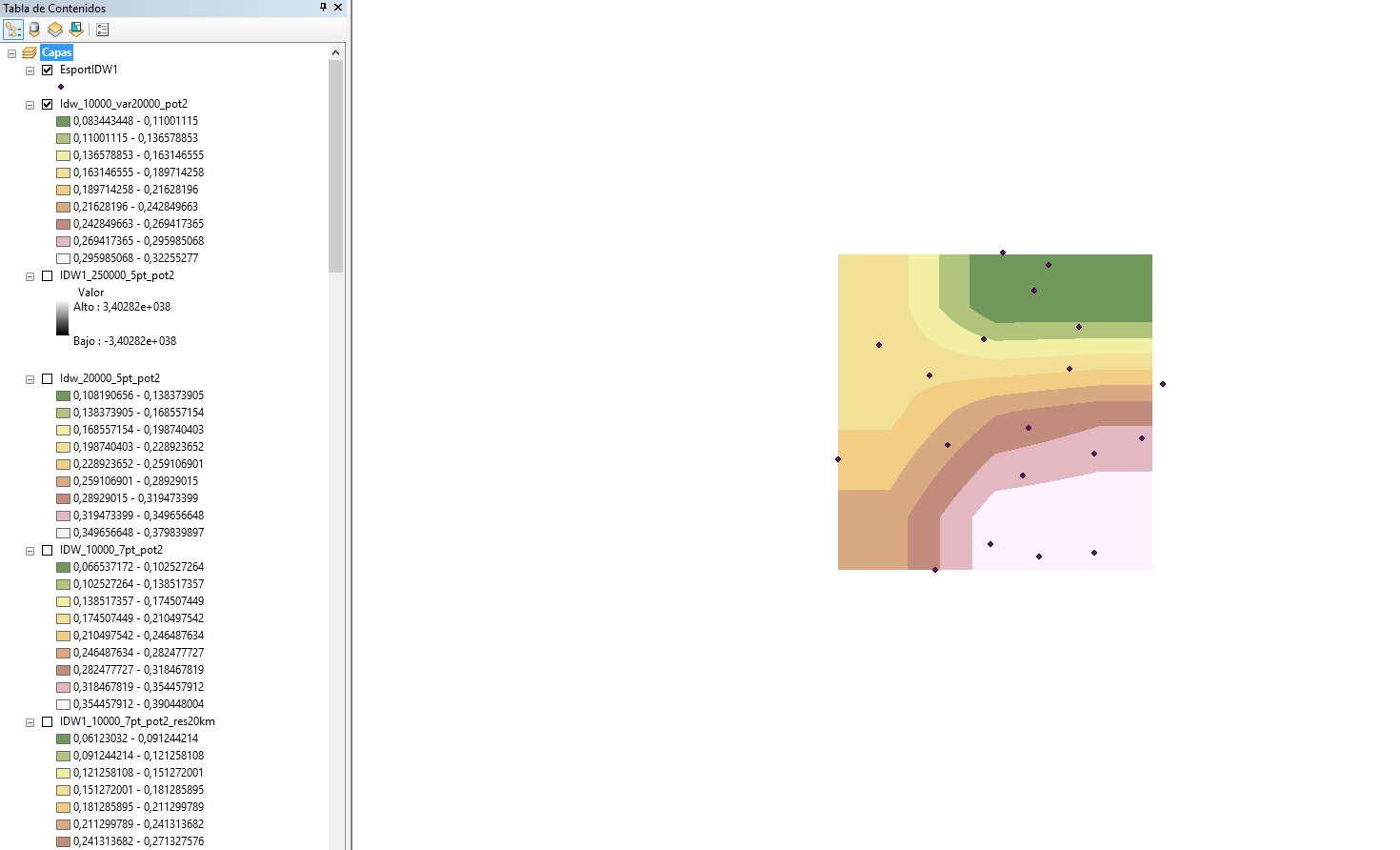

I'm doing my end-of-degree about geostatistical interpolation. I'm using IDW to interpolate some  Soil Moisture data from a surface. The  thing is, that I'm looking for one single value for the whole area I'm interpolating (because I need to compare it with the soil  moisture mesaured in the whole area by satellite). I don't know which parameter I should vary to accomplish that aim.
Thanks in advance for the help

thanks for advice. The aim of the project is to test some methods to interpolate the SM to get to know if the classical mean is cost-effective. I got the grid showwnMy points
And when I try to use IDW,  I always get things like that:
Which I know is the common thing. But, what I need, is to get, one single value. I tried to change  the  Z resolution, but it seems that it doesn't listen to me.
I don't know what to do.
Thanks in advance

If you are seeking a single value, why are you interpolating a surface? Could you simply get statistics on the selected point data, and then choose which statistic you wish to use (ie: mean value)?
Regards,
Jim
