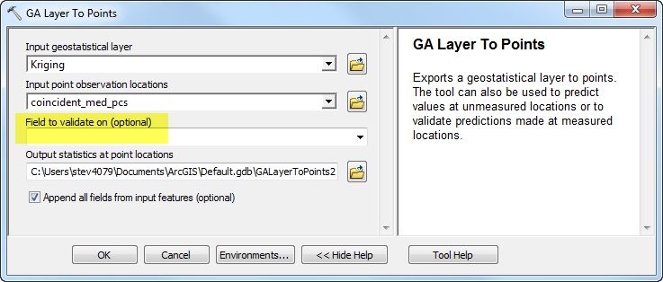

Maybe you misunderstood me.
To get the same prediction values as in the Wizard use the GA Layer To Points tool and leave the "Field to validate on" blank (i.e empty).

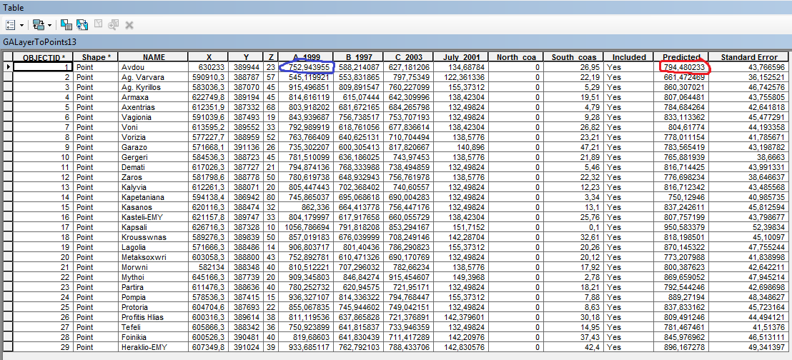

I did this and the result was this:
the result in wizard was this:
the value in red circle is 794.48 and in the wizard is 834.54. It is not the same. Why?
SteveLynch
Those are not really prediction values.
In cross validation - Removes one data location and predicts the associated data using the data at the rest of the locations. The primary use for this tool is to compare the predicted value to the observed value in order to obtain useful information about some of your model parameters.
To get those values you need to run the Cross Validation tool.
