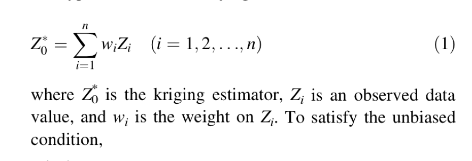

I'am searching for the function of EBK Regression Prediction, for example for the ordinary kriging we have:

zohrael_mouadane
thank you for your answer, I already know the procedure that generates the predictions but at this stage I need the EBK regression prediction formula ,I searched for it and couldn't found it.
