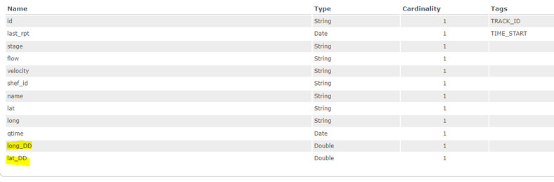

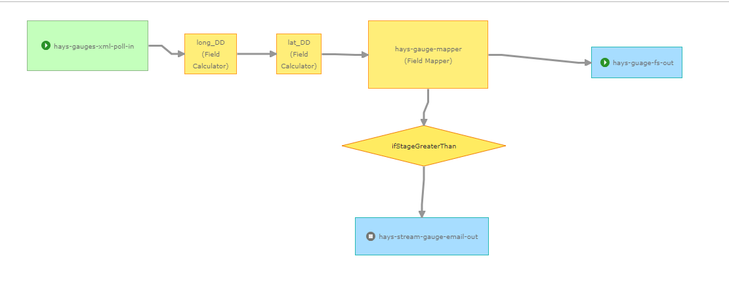

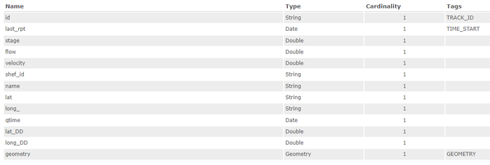

I needed to set up my input definition to include the two new fields that I was going to convert my DMS values to DD values to. Then in the geo event service, set up my field calculators to convert the values from DMS to DD and store in those new fields. Finally map them out to my output. Screenshots below for each piece of the pie. Hopefully someone gets something from this in the future!
XML Feed:
https://hayscounty.wetec.us/WETMap/public/hayswlpublic.xml
Input Definition with new fields highlighted:

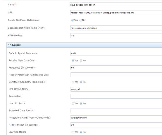

XML Input Connector:

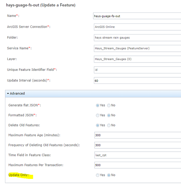

Hosted feature service output connector, make sure Update only is "NO":

Geoevent Service outputs to a hosted feature service, and sends email.

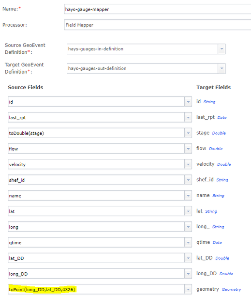

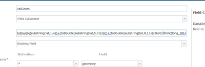

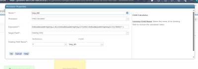

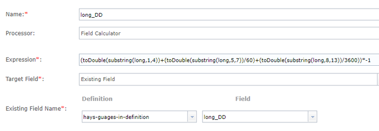

Example Field Calculator that converts the XML DMS string value to a double DD value.
In the field mapper, using the DD values for latitude and longitude to construct the geometry.

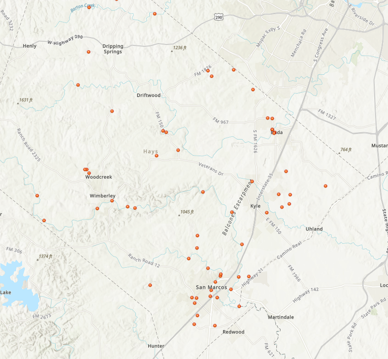

Data mapped to hosted feature service.

I'll give it a try. Should I just do all of my calculations within a field mapper? That is convert my laititude, longitude, and geometry all from one field mapper processor. Rather than trying to use seperate field calculators for each operation? I have pasted images of my setup below.
Gene_Sipes

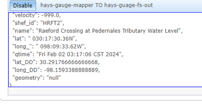

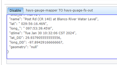

This is what ends up happening. My latitude and longitude correctly convert, but geometry is null.

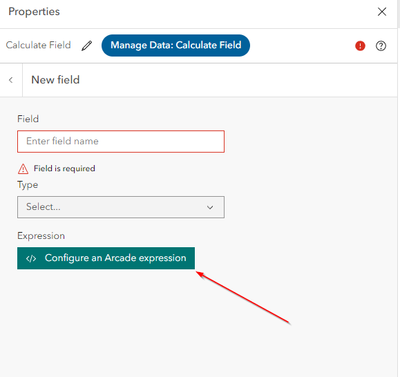

That makes sense, but I am not sure how to write more than one line expressions in the field calculator or the field mapper.
JeffSilberberg
I either Field Calc or Field Map, click on the Configure Arcade Expression.  Be sure to test/run it after you have it built.
Gene_Sipes
Ah man... I gues my version doesn't have that button. I am using 10.9.1 (build 28388).

Yea, no dice. I built the expression in VS Code and pasted into the field mapper for the geometry, but it writes out a null value for geometry.
Gene_Sipes_0-1706887227268.pngGene_Sipes_1-1706887257036.pngGene_Sipes_2-1706887274547.png
Logs are citing that I have invalid field mapping for both my Point function and my variables lat_DD and long_DD
