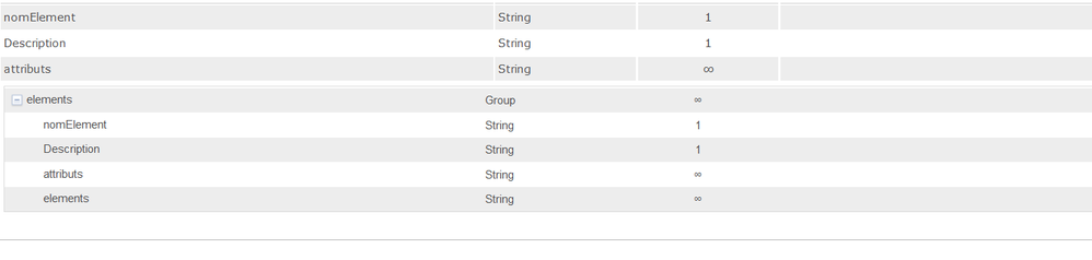

Hi guys,
I am using the "Watch a Folder for New JSON Files" as an ArcGIS Geoevent input connector, however, the GeoEventDefinition is being created with some missing attributes.
The json file looks like this :
{ "application/json": [ { "nomElement": "", "Description": "", "attributs": [], "elements": [ { "nomElement": "", "Description": "", "attributs": [], "elements": [] }, { "nomElement": "", "Description": "", "attributs": [ { "nomAttribut": "", "values": [ { "mesure": "", "horodatage": "", "unite": "" } ] }, { "nomAttribut": "", "values": [ { "mesure": "", "horodatage": "2021-10-05T14:23:44.1376727+02:00", "unite": "" } ] } ], "elements": [] },
The created definition looks like this:

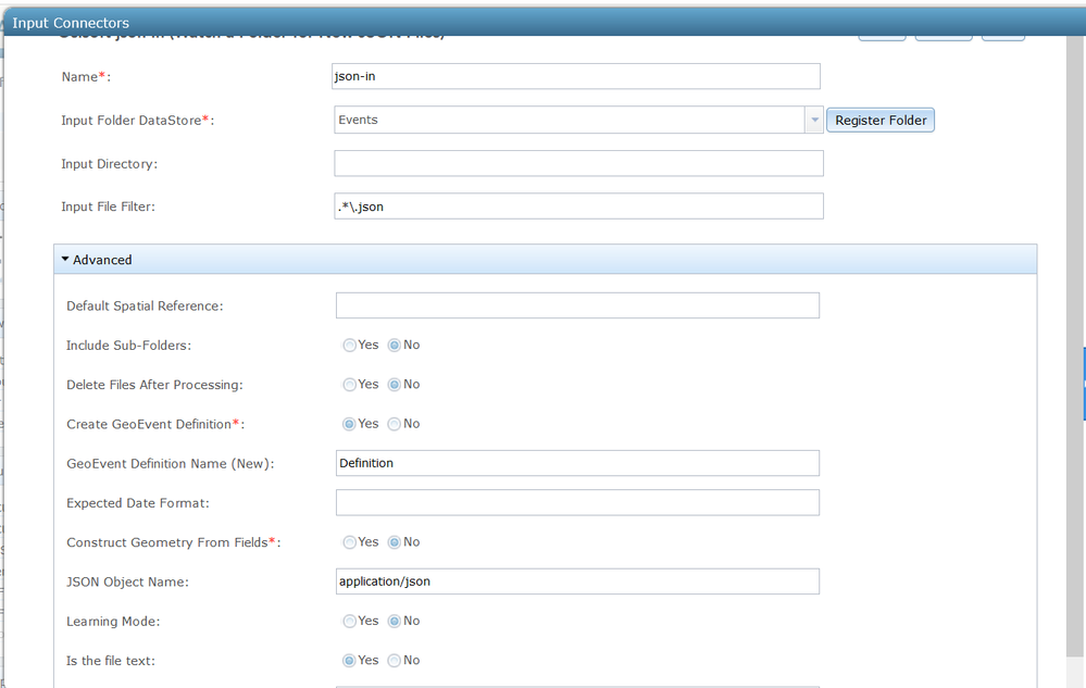

While the input connector configuration looks like this :
I am wondering if i am missing any thing ? @RJSunderman @EricIronside

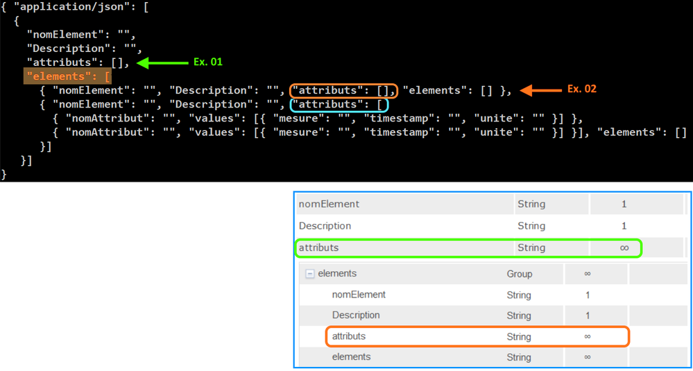

The hierarchy in the JSON data structure you illustrated looks almost recursive. If this is a typical example of the JSON an input you have configured would expect to receive as its first data record, I think the inbound adapter is making its best guess at what the GeoEvent Definition ought to be. An inbound adapter's guess will be more accurate for simpler data structures -- the adapter will not recursively iterate through a data structure to further refine what it sees up-front.
For example, in my illustration above I've added just a little white-space and formatting to your JSON example. The line I've designated "Ex. 01" in green is intended to be an array capable of holding zero or more data values. But the adapter, given the empty array in the illustration, does not know whether the array's data will (eventually) be a set of integer values, a set of string values, or a set of JSON elements with a more detailed sub-structure.
Given the empty array, the inbound adapter makes a guess and assumes a data type of String and a cardinality for the data value of Many (indicated with the infinity symbol circled in green in the illustrated GeoEvent Definition). As long as the data values eventually received in that array can be implicitly cast to String the adapter will be able to parse and adapt data it (eventually) receives.
Looking at another part of the data structure, designated "Ex. 02" and highlighted in orange, we see an "elements" array which contains JSON elements (as opposed to primitive String or Integer values). But the two JSON elements shown in the example have potentially different sub-structures.
The first "attributes" array (boxed off in orange) is empty. As before the inbound adapter makes a guess and assumes an eventual data type of String setting the cardinality to Many (result circled in orange in the illustrated GeoEvent Definition). Again, the inbound adapter is not going to recuse more deeply into the data to see the other "attributes" (boxed off in blue) -- so it will not see that its first assumption is wrong and that "attributs" is probably not going to be an array of String values. The inbound adapter will not know that a key "attributes" found within "elements" is actually be intended to hold zero of more JSON elements with their own sub-structure.

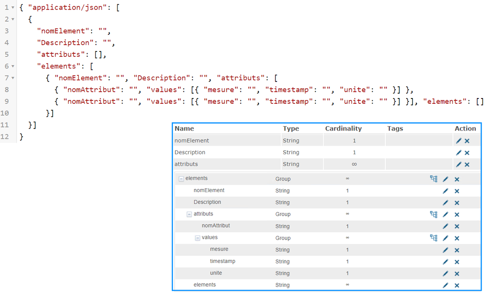

A quick test, removing the line I've designated "Ex. 02" above, confirms that a JSON inbound adapter receiving the JSON illustrated below will assume a data type Group for an "attributs" key found nested beneath a key "elements":
I suspect the GeoEvent Definition in this second illustration is closer to what you were expecting.
