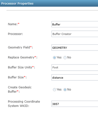

You won't be able to update the point feature service, but you can output the buffers to a new polygon feature service using the Buffer Creator processor.  Below is an example of how this is setup.  It's getting the buffer distance from a field called distance:
For the Coordinate System, make sure you specify a Projected Coordinate System.
