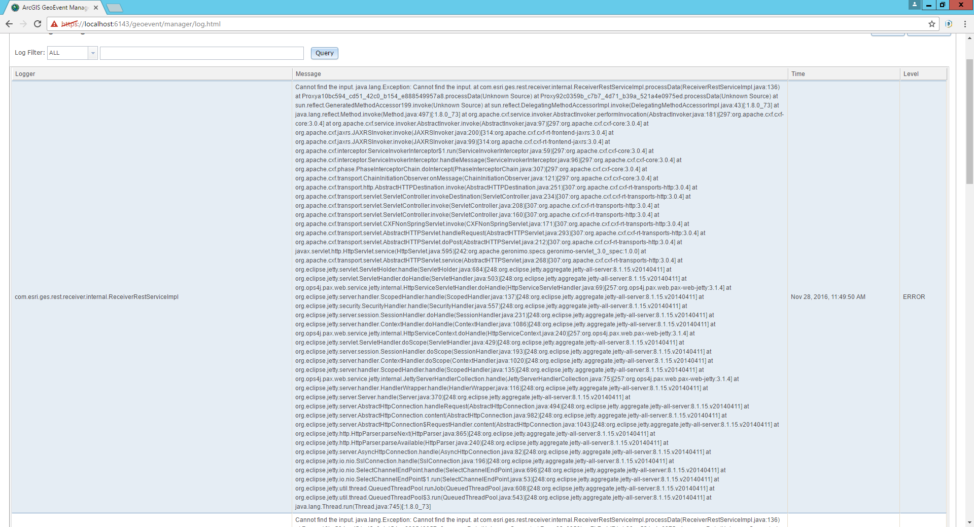

I lost my incoming connection between verizon and geoevent overnight.  Now I am getting a pretty regular list of errors(see attached) and the Input connector is only handling events about every 20 seconds.  I dont think there were any updates performed on the server so this kind of came out of nowhere.  At first when I tried to login to GE Manager it could not find the service.  After a server restart everything came back up and I was able to login.  Now I am getting all of these errors.
The latest error message:
Logger:  org.apache.cxf.jaxrs.utils.JAXRSUtils      Message:   Problem with writing the data, class java.lang.String, ContentType: application/json
Im not really sure where to start.

When observing the attached photo of the logs, it indicates a RabbitMQ Platform Service failure. This platform service is housed inside the ArcGIS Server installation, and facilitates the movement of messages from the input connector to other components within GeoEvent. I would start with conducting a software repair on the ArcGIS Server, as the platform services files may have become corrupted at some point.
Although updates may not have been installed, a machine failure could be a possibility as well. It would also be fair to rule out any machine failure as a potential cause alongside of the ArcGIS Server/GeoEvent software.
