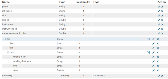

Greetings community,
Using ArcGIS Enterprise 10.8.1, I am attempting to ingest files containing sensor data. This data is generated by an external application in geojson format. I have attempted to use folder monitoring and polling an external website to retrieve the file, but it fails to generate events from the file.

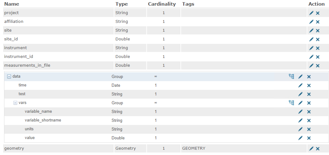

It seems to have some difficulty creating a definition on its own. Even if I let it create the definition, events are not created. So I configured this geoevent definition:
I enabled debug logging, and it seems that it is hanging up on parsing the file. I've attached that section of the log file, as well as a text version of the geojson file.
I've run out of things to check. Any ideas?
Thanks!
Brandon

Hello Brandon,
   Did you try to flatten the definition with the field mapper? GeoEvent has a "tenuous" relationship with non-flattened definitions. Let me know how this goes for you!
