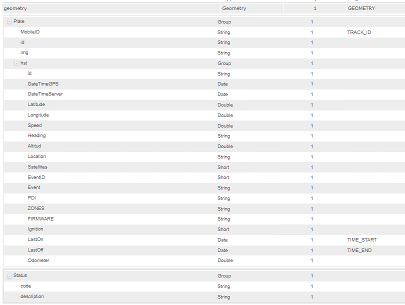

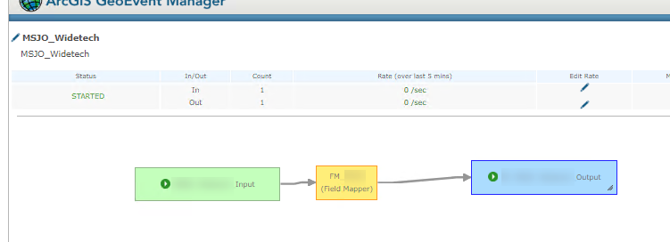

Environment.
Its ArcGIS Enterprise 10.9.1 (federated with relational Data Store) and ArcGIS GeoEvent 10.8.1; the environment is distributed in several virtual machines, with certificates signed by a commercial CA, and using Windows Server 2019 Standard.

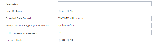

Definition of the Input (WS XML Service).
Input (WS with XML).

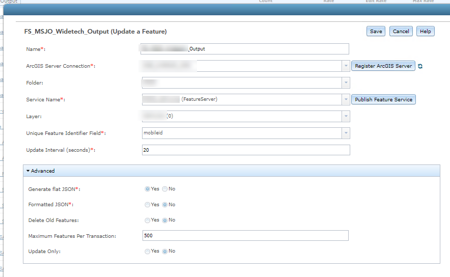

Definition of the Ouput (Update feature ArcGIS Enterprise Hosted).
Output (Update feature ArcGIS Enterprise Hosted)

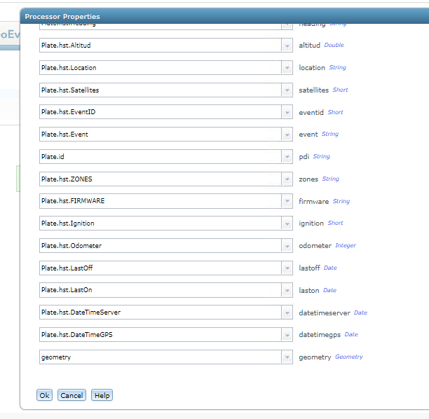

FieldMapper.

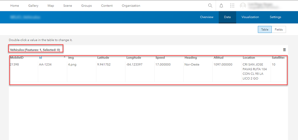

Result (Hosted Feature in AGE).
