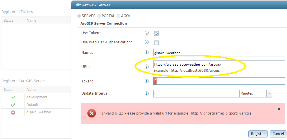

I am having trouble connecting to an external ArcGIS Server in GeoEvent 10.3.1
The URL is https://gis.aes.accuweather.com/arcgis
The connection is valid in GeoEvent 10.2.2
In GeoEvent 10.3.1 is there URL format-checking happening behind the scenes when connecting to an external ArcGIS Server? Could this be preventing us from saving the connection?
KDeVogelaere
Deactivated User
We are behind a proxy, can GeoEvent 10.3.1 be configured to set the proxy URL?
Console log:
Failed to load resource: the server responded with a status of 502 (Bad Gateway).
UPDATE 1/8/16
Figured it out, hope this helps someone out there
  • Logging into GeoEvent Manager
  • Go to Site
  • Settings
  • Then add proxy host and port settings for:
    • Http Proxy Host
    • Http Proxy Port
    • Https Proxy Host
    • Https Proxy Port
