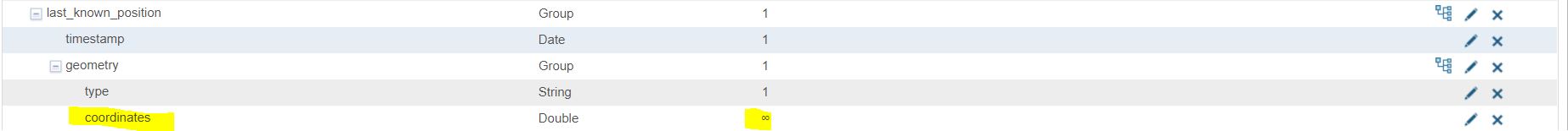

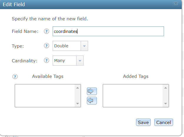

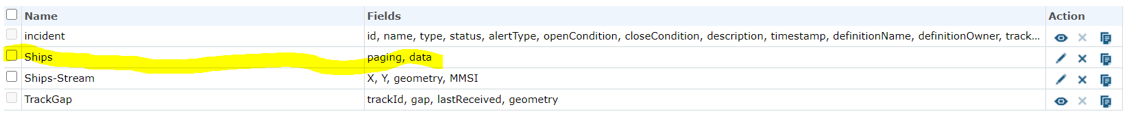

Hi -
I am working with the JSON below.  I would like to use data.last_known_position.geometry.coordinates as my X and Y.  The goal is to send the JSON to a stream service.  I am using the connector poll and external website for JSON.  I have referenced this thread here Parse JSON location data from array , to no avail.  My logs indicate that the fields data.last_known_position.geometry.coordinates[0] and data.last_known_position.geometry.coordinates[1] do no exist which would construct the geometry.  When I select "Create a GeoEvent Definition" for my input, the definition that is created contains many cardinality for the coordinates array. How can I get the values from data.last_known_position.geometry.coordinates to create my geometry?
