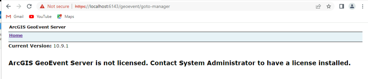

I have been trying to get Geoevent Server 10.91 to work on an Azure VM for over week. I had a damaged certificate issues  and other hassles but made progress.
I am now really stumped by this license error I get when trying to access the manager page.  "ArcGIS GeoEvent Server is not licensed. Contact System Administrator to have a license installed."
This is after the licensing the software online and getting a confirmation that the software is ready to use.  I have checked the keycodes and it is listed  and expires only in March 2023.
I have reinstalled all the ESRI software removing any trace of it anywhere on the server, rebooted it, cleared the browser cache, drawn a pentagram on the floor, and sat in the lotus position, nothing helps 🙂
Does anybody have some advice of what might be wrong.
Thanks
Martin
Jordan
If you login to the ArcGIS Server Manager that hosts GeoEvent (https://localhost:6443/arcgis/manager) and go to Site > Software Authorization, it displays the ArcGIS GeoEvent Server role as active, with the expiry?
mcocks_ESRICT
Hi
Thanks for your reply, it helped. Turns out I had taken for granted that I had the correct ECP code. I found there was another that was correct  but not shared with me...  a wild goose chase.
It's up and running now!
