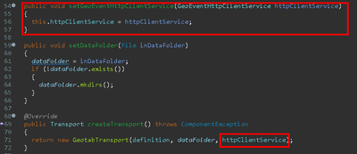

To make periodic HTTP requests, you will want to use the GeoEvent's HTTP Client Service. To gain access to it, you will want to add it to your Blueprint configuration as displayed below.
Then back in your Transport's service class you will need to add a method to set the HTTP Client Service and then add it to your Transport's constructor.
Here's a brief example of how to use the GeoEvent HTTP Client inside your Transport class.
Once you have all that, you can access the file with IDs from your data folder and use the HTTP Client Service to make HTTP requests.
