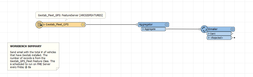

I created a workspace using Safe Software's FME Form that does this. The workspace reads from the Feature Service that is used for the GeoEvent Service. It sends me an email with a weekly count of the number of vehicles in the GeoEvent Service. It's a lot easier to use FME than GeoEvent Server to do this.
I published the workspace to FME Flow (formerly FME Server) and run it in an Automation.
