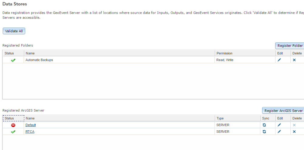

My Default Data Store in GeoEvent is not validated, as it failed after I secured the REST service.
GeoEvent Data Store
As you can see, I've registered a second ArcGIS Server connection to the same URL and called it RTCA:
RTCA Register

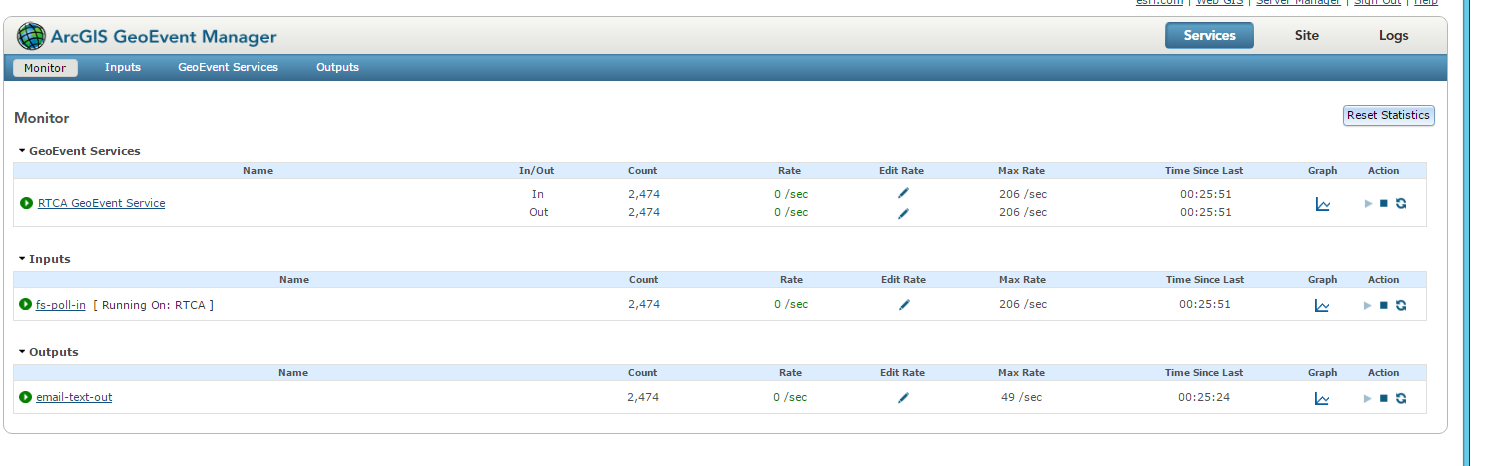

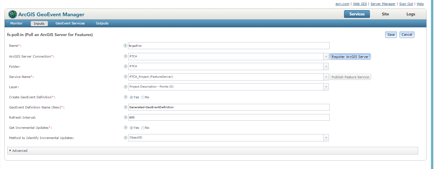

The issue is that, while this second data store will validate and allow my GeoEvent Service to function correctly temporarily...
Monitor
When I check on the status of the Service after ~ 24 hours, the fs-poll-in Input will have stopped running and the Data Store is no longer validated.

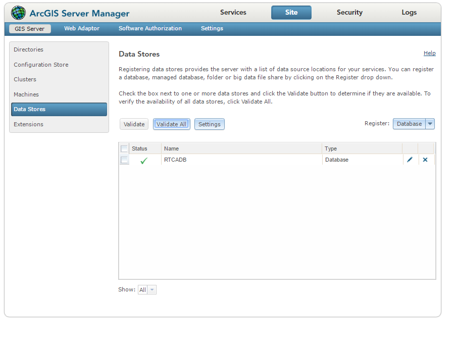

For what it's worth, the same data store is perfectly valid within ArcGIS Server Manager:
Server Manager

There were fixes which appear related to the issue you're describing in patches released for the 10.4.1 and 10.5 product releases. If you haven't already, would you please download and apply one of the following, which ever one is appropriate for your deployment:
Esri Technical Support might be able to offer assistance. If you elect to submit a support incident, you might reference BUG-000100502.
Hope this information helps -
