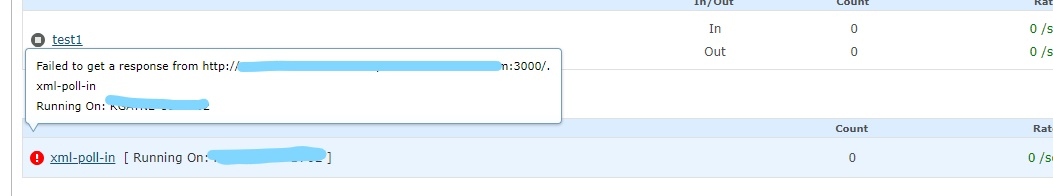

Update: Now, I have set up an AWS EC2 instance, and running the server there. On starting the input connector getting this error: 'Failed to get a response from <url>'.
