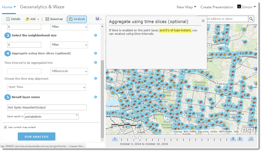

I have a layer in the ArcGIS Spatiotemporal Data Store.  This is live data and is being fed continuously via GeoEvent.
Using the Geoanalytics tools in the Portal Map Viewer, I was hoping to do some temporal analysis using this live data source.  However, for the hot spot analysis tool, within the settings for the tool, the 'Aggregate using time slices' option is disabled and the info mentions:
If time is enabled on the point layer, and it's of type instant, you can analyze using time intervals.
As the below screenshot indicates, the time slider indicates that time has been enabled for this layer.  I am wondering on if this tool works with live data, and for some more info on what is meant by 'instant data'.
Tool disabled

SimonJackson
Thanks for response.
Followed steps 1-4 and can confirm that the same layer has time enabled.
But time settings still disabled:
Same if I try the GeoAnalytics --> Aggregate Points tool
Bit confused as the time slider on the map behaves as expected with the layer.
