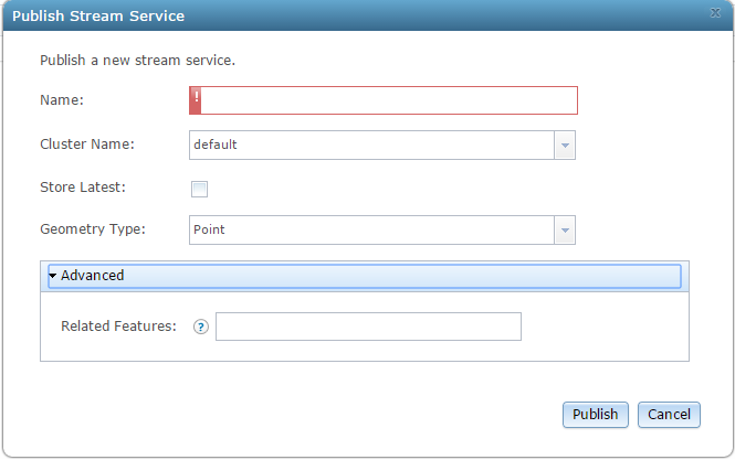

When you Publish a Stream Service there is the option of including a URL to a Feature Layer as Related Features.
From all the information I got this option allows you to stream data through a Stream Service that does not include geometry. The client (javascript) will join the features using the TrackId field between data coming from the websocket (Stream Service) and features in the Related Feature Layer.
I'm trying to get this to work, but I haven't had any success. I'm looking for a working example of this setup, so that I can use that as a reference. That is, make sure I've configured everything correctly.

Thanks for the explanation. To accomplish what you need must be performed in the GeoEvent Manager on the Outputs section. By adding an Output connector, you can Publish your Stream Service and configure it. You must click the Publish Stream Service button after providing a Service Name. This will create your stream service url. As long as you provide a URL to the Related Feature as well. Once I Published the Stream Service everything fell into place.
Create your Input Connector and the GeoEvent Processor to assist with what your trying to accomplish. About your screenshot, I can't tell if you're in the GeoEvent Manager or the ArcGIS Manager section.

A stream service output's 'Related Feature' property is a URL which is passed along to clients subscribing to the stream service. GeoEvent does not actually do anything with this URL (other than pass it along to clients). Clicking 'Subscribe' on the stream service's HTML page in the ArcGIS REST Services Directory, for example, will not show you any enrichment. The intent is that a real-time data stream, rich with attributes but missing a Geometry, can link to a related feature service which contains *only* the location (Geometry) for sensors in a network so that the real-time sensor data can be displayed on a web map.
I've attached a PDF with several steps which illustrate how the 'Related Features' capability is supposed to work when using Stream Services. I shared these with you off-forum already ... I'm posting them here for the benefit of the community.
