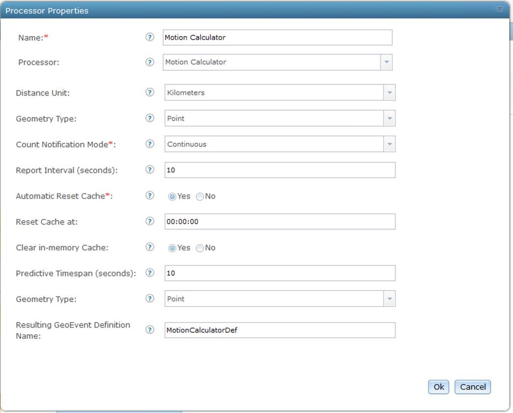

Hi,
using ESRI's sample processor 'Motion Calculator', we see unexpected results in the outcome data. I guess this is due to misconfigurations. However, no documentation or explanation is available (or I can't find it).
Could the configuration parameters be documented or briefly explained?
In what unit is speed defined?
Thx in advance!
Best regards,
Dries

MorakotPilouk
The speed unit is the same as the selected distance unit per hour, e.g. Kilometers/hour, Miles/hour. The calculation relies on the temporal order of the incoming messages. It may provide strange results in case of store-and-forward messages where message timestamps were in the past. Small time span may also results in very large number.
Please note that these calculations don't work well if the incoming messages are from the GeoEvent Simulator with overridden timestamp at the data rate not matching the real world rate during data capture because the calculated timespan between two consecutive messages won't reflect the actual timespan.
