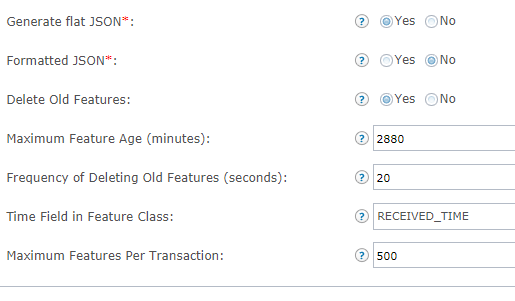

I would like to use the 'delete old features' setting on the 'Add a Feature' output in order to purge old records. I have a date field which is calculated using "receivedTime()". However, when I use the settings in the image below the records are not deleted. I have tried inputting unix time into a integer field (date field will not accept it) but I am unable to select anything but a date field for the "Time Field in Feature Class". Can someone give me some guidance on using the "Delete Old Features" setting for the "Add a Feature output"?
Using Geoevent 10.6, SQL Express database
Thanks

Your configuration of your output looks correct. For my test I chose to have the output delete any feature records which are older than two minutes, attempting to delete "old" records every 30 seconds:

BrianLomas
Hey RJ,
Thanks for the thorough answer and for getting back with me so quickly, I appreciate it.
The 'received_time' field is not being mapped.
The field calculator for the 'received_time' field...
My 'received_time'  field is set to date in the GE definition
A query on the Rest endpoint confirms the time is being processed as Epoch time.
The log file appears to have the appropriate where phrase and the HTTP response appears to be successful. However, no records are being deleted from the feature class. The feature class records range from 9/23/2018 - current date/time.
