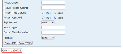

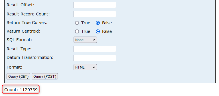

Our Big Data Store is now hosting more than 1 million points, here is the exact count by querying the feature layer :

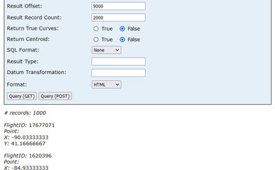

We were not able to query the data beyond the 10 000th record by using the result offset. For an example if we want to retrieve the 2 000 records between 9 000-11 000, the feature layer will only fetch 1 000 records.

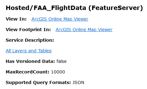

the service is configured by default with Maxrecordcount=10 000 but I assume using a Result Offset, I do not have to change this setting to fetch the 1000 records missing in our example.
