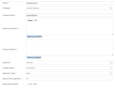

Thanks for your reply. I checked your document. This is how i designed the processors, I am not sure what am I doing wrong:
First one, which will detect the speeding:

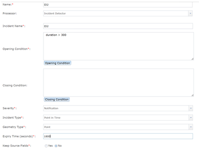

And this is the second processor for time:
Thanks for your help!
JeffSilberberg
duration is in  Milliseconds. so  30 minutes is 1800000 ms  not 300.
