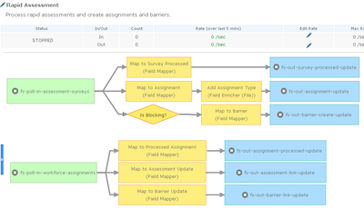

Currently, when exporting a GeoEvent configuration, the user only has 2 options:
  1. Export all inputs, outputs, definitions, services, etc on the machine
  2. Export only specific inputs, outputs, etc (each to a specific file)
We need a way to easily export an entire configuration for a specific GeoEvent service (and its related inputs, outputs, definitions, geofences) into a single file so a user can easily move it to another machine without having to piecemeal config files for each specific component.

If you choose 'Selective' and 'Service' it will output a configuration file with only the things the Service contains (inputs, outputs, definitions). So based on this, I think GES already does what you are asking.

Thanks Eric. Looks like I am missing data stores and geofences when I do a selective export of just the geoevent service and load into another machine

The Data Stores should be in there.  It doesn't export the passwords to the datastores, so you will have to enter those in manually.
Unfortunately, the GeoFences and GeoFence Synchronizations will need to be done separately.
