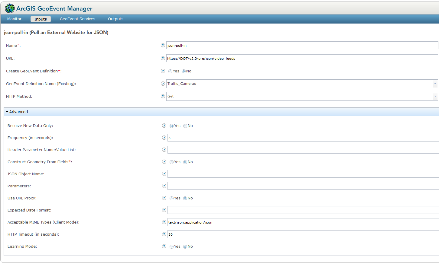

The issue is most likely that the Acceptable MIME Types (Client Mode) parameter is not set correctly.  For example, I setup up the following Poll an External Website for JSON input:
It saves correctly, but when viewing the Input no events are coming through:

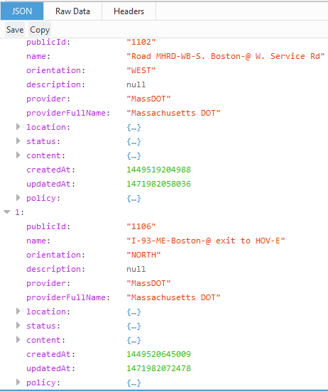

If the URL is added to a web browser, the correct information is returned:

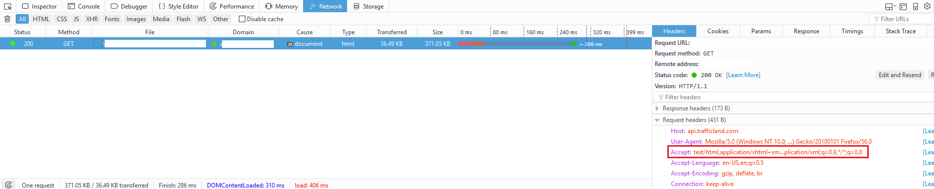

The above was taken from FireFox.  Using the Web Developer tools included with FireFox I can find the MIME types that are used.  To do this click Ctrl+Shift+K to open the Web Console.  Click on the Network tab, and in the right panel click on Headers.  Under Request headers you will see the parameter Accept:

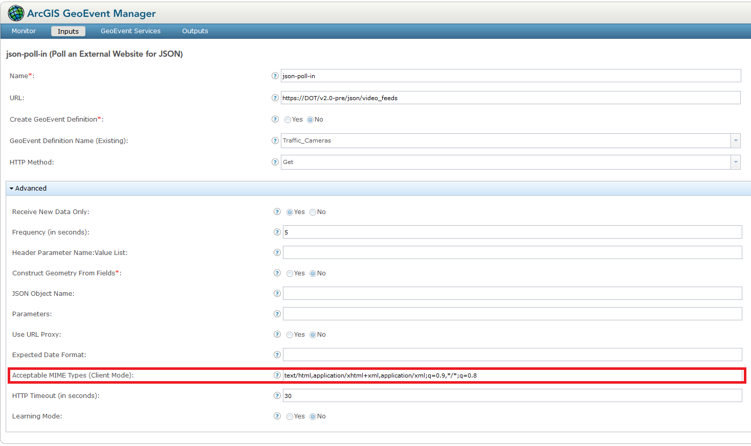

Copy this information and paste it in the Acceptable MIME Types (Client Mode) parameter for your input:
After saving the changes, the input now receives the events:
