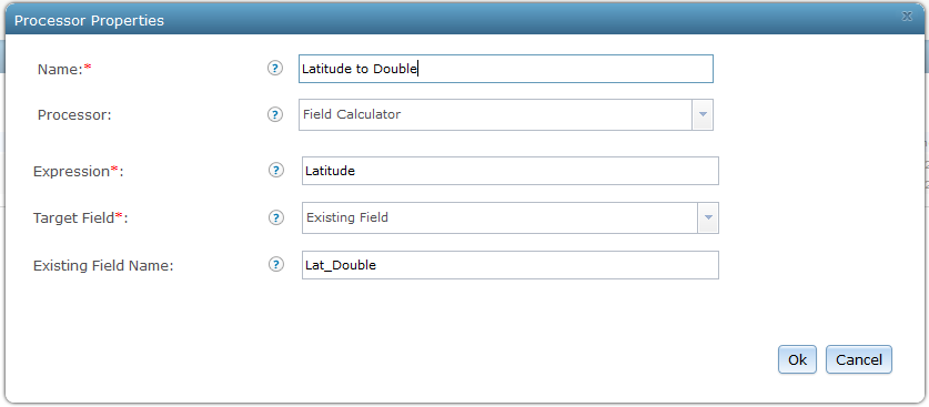

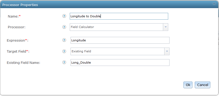

4.  In the GeoEvent Service the Long_Double and Lat_Double fields were CAST values from the original Longitude/Latitude fields using the Field Calculator:

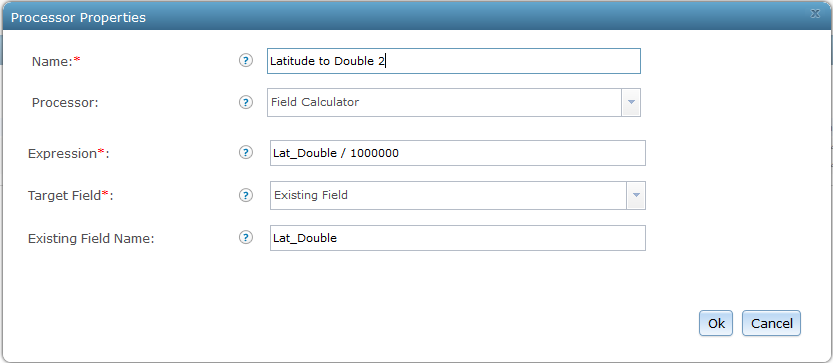

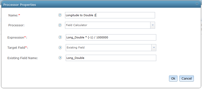

5.  The Field Calculator was used again to add the negative to the Long_Double field and to add a decimal by dividing both Long_Double and Lat_Double by 1,000,000:

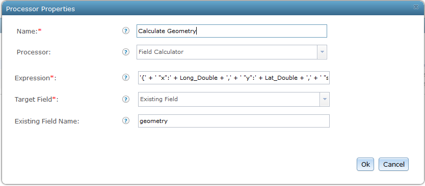

6.  Now that there are fields of type Double that are formatted correctly, the Geometry field can be calculated.  This expression was a little more complex:
'{' + ' "x":' + Long_Double + ',' + ' "y":' + Lat_Double + ',' + ' "spatialReference":{"wkid":4326} }'
The spatial reference (4326) is for WGS_84 in this example.

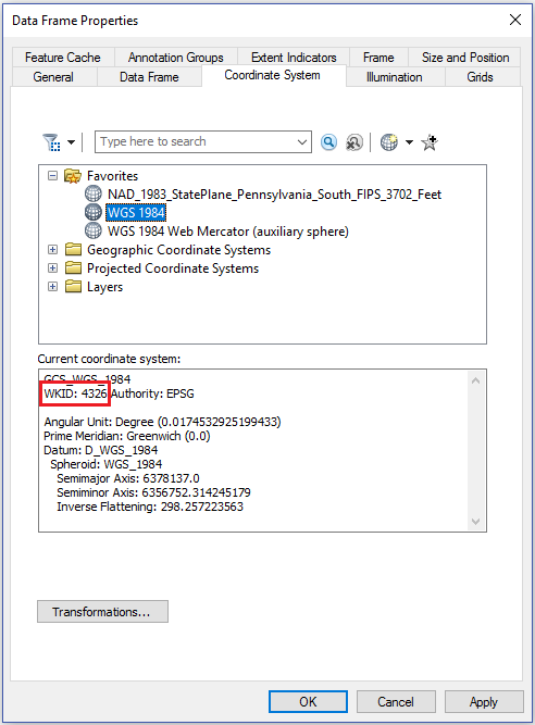

Hint:  An easy way to find the WKID is to search for the coordinate system using ArcMap's Data Frame Properties:

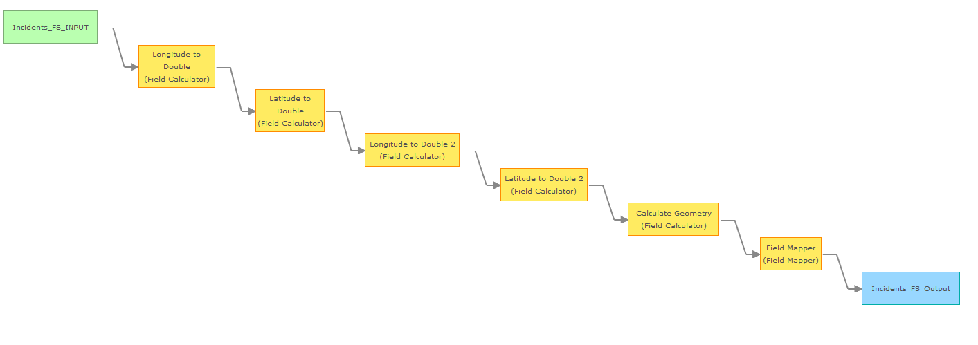

7.  The Field Mapper processor was added to ensure the fields are mapped correctly to the feature service.  Below is a look at the GeoEvent Service:
As the database table was updated GeoEvent successfully converted the Longitude/Latitude values to Doubles, created geometry from these values, and updated the feature service.
