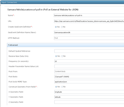

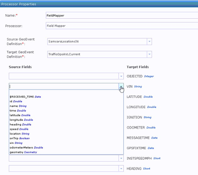

Here is the input connector. Whether or not set the date format on inbound connector did not matter.
In GEP 10.4.1 the time is long. In GEP 10.8.1, the time is double. If I add a field mapper to map the time to a date field, the datefield would be null. If I convert the double to long, then some row on the date field was 1/1/1970, most row of the date field were still null.
That's was a test service that just wanted to get the time mapped to the date field correctly.

I am going to request we take any further troubleshooting through Esri Technical Support. From what you've shared I'm assuming that the GeoEvent Definition you've configured your Poll an External Website for JSON to create for you (e.g. SamsaraLocationsIN) recognized the attribute time in the data received from Samsara as a numeric value. When allowing an input to create a GeoEvent Definition for you, numeric values are adapted as a Double (because a Double is the most generic way to handle a numeric value).
If indeed the time in the Samsara data record is a 13-digit epoch expressing milliseconds -- not a 10-digit epoch expressing seconds -- then you should be able to simply copy the SamsaraLocationsIN GeoEvent Definition the input created for you and edit your copy to specify that the attribute value time should be adapted as a Date.
You should then delete the auto-generated SamsaraLocationsIN GeoEvent Definition and reconfigure your Poll an External Website for JSON input to use your copy of the GeoEvent Definition, the one you've tailored specifically to adapt time as a Date.
