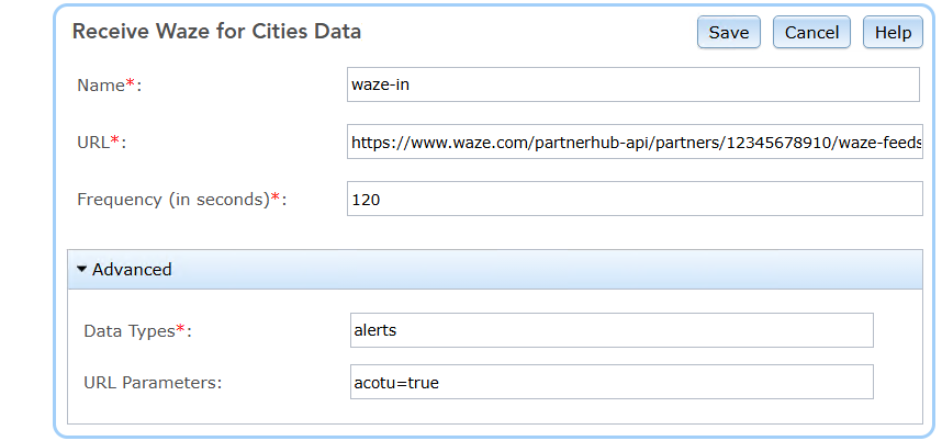

The configuration panel used to enter your Waze Partner URL and request data has been simplified. An example is shown below.
  • Enter a descriptive name for your inbound connector (e.g. replace 'waze-in' with any name)
  • Enter the full URL provided to you from Waze to allow GeoEvent Server to query the API for data:
  • The recommended default rate to query the Waze API for new traffic alerts and jams is 120 seconds. You can set this value as low as 30 seconds, but the Waze API may not respond with data every query.
  • The default query specifies both alerts,traffic data types should be included. It is recommend you choose one (alerts or traffic). If you want both traffic alerts and traffic jams, configure two Waze inputs. The geometry and data schema is different for alerts than it is for traffic jams, and you will need to account for this when configuring processors like Field Mapper to flatten an event record's hierarchical structure.

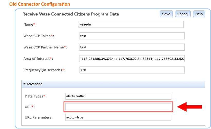

Earlier ArcGIS Releases
Earlier releases of GeoEvent Server may display a version of the input configuration which requires you to enter parameter values for a Waze CCP Token and Waze CCP Partner Name. You can enter the values 'test' and 'test' as shown below. ( These properties are now encoded in the URL provided by Waze. )
