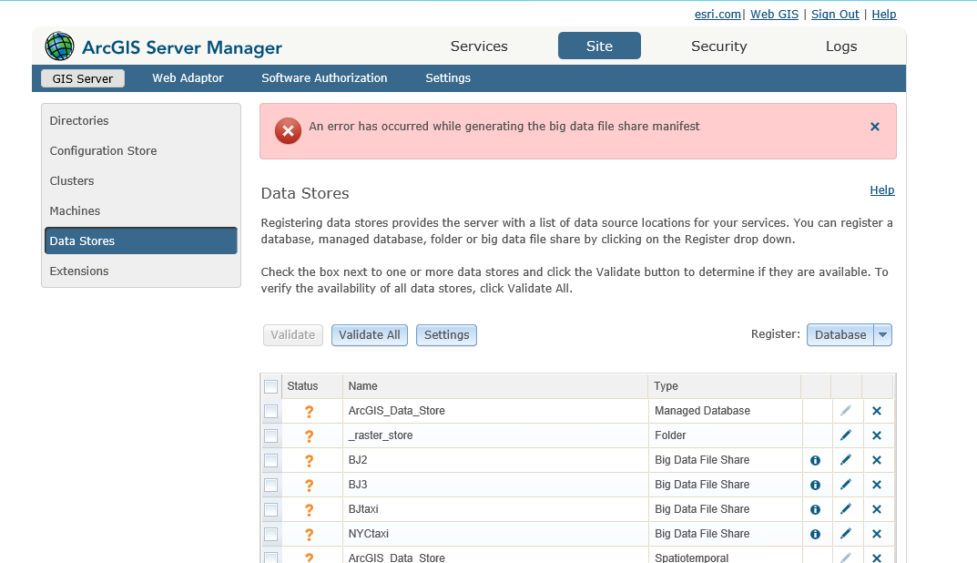

when I register Big Data File Share,I offen have the problem:"An error has occurred while generating the big data file share manifest"
and the logs write:

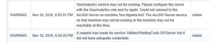

Error executing tool. GenerateManifest Job ID: jd1493492bc3e4340aeb383990daa2757 : {"messageCode":"BD_101030","message":"Failed to execute GenerateManifest. Please contact your administrator with job ID 'jd1493492bc3e4340aeb383990daa2757'.","params":{"toolName":"GenerateManifest","jobID":"jd1493492bc3e4340aeb383990daa2757"}} Failed to execute (GenerateManifest).System/GeoAnalyticsTools.GPServer
Failed to execute GenerateManifest. Please contact your administrator with job ID 'jd1493492bc3e4340aeb383990daa2757'.System/GeoAnalyticsTools.GPServer
when It appeared some times unfederated Server and federated it again may be back to normal but most of time It doesn't work .So I have to unfederated Server and reinstall portal . So what's the problem of Geoanalytices Server of ArcGIS 10.5 prerelease??

I am. 4 weeks ago, I set up all environment: geoanalytics ( 2 machine ), portal, spatiotemporal d.s. ( 3 machines ) and hosting server. It was fine, it generated manifest and hints file easily for taxi data in the tutorial. Then we deleted all virtual machines and set all of them up again.
It says " An error occured while generating big data file share manifest "
I unfederated/federated , stop/start services, check license, change .csv files, also add our shapefile test data, try green taxi data..
At troubleshooting:
Common GeoAnalytics problems and solutions—Documentation | ArcGIS Enterprise
After I generate a big data file share, there are no datasets in my manifest. What's wrong?
If a manifest contains no datasets, there are two potential problems:
  1. The location selected for the big data file share did not contain the correct folder structure. To learn about the correct folder structure, see Registering your data with ArcGIS Server using Manager.
  2. The datasets are not in the required format. To learn more about the types of data you can register using a big data file share, see What is a big data file share.
The folder structure is correct. Because it was OK a few weeks ago. Dataset is fine because it's tutorial dataset. Also I wrote a manifest file as .txt format and tried to upload that, it fails again.
Do you have any idea?
