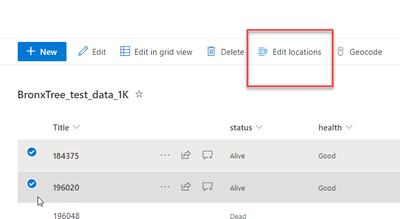

Hi,
I've had multiple SharePoint lists working for a while now. They have columns for the multiple lines of text with the X & Y co-ordinates. Users could then use the Edit Locations option to update this if an address was Geo coded incorrectly. When this happens we then use Power Automate to update the feature on the relevant map. Our SharePoint Online has updated to the new version & we've now lost this feature for Edit Locations . I've updated the Add In ArcGIS app on our tenant but it's still the same. I've also tried switching the list to Classic experience. Has anybody else come across this?

Looks like MS has rolled back the update. The "Edit locations" button should appear now.

Thanks for the post. We are able to reproduce the issue on our end after the SharePoint Online update. We are currently investigating this issue on our end to determine if we need to make any changes to the ArcGIS for SharePoint app in order to be compatible with the new SharePoint online version. I will keep you posted on the progress.

As a workaround, can you request your users to add the "list" web part to a SharePoint page and make their edits there? The "Edit locations" button appears and works without any issues if invoked from the "list" web part. I will keep you posted on any further updates.
