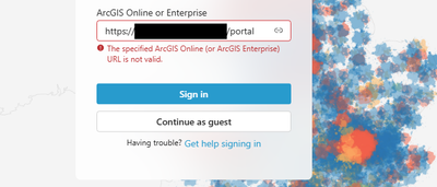

The error:
"The specified ArcGIS Online (or ArcGIS Enterprise) URL is not valid."
The specified ArcGIS Online (or ArcGIS Enterprise) URL is not valid.The specified ArcGIS Online (or ArcGIS Enterprise) URL is not valid.
This is only an issue when the DNS server directs traffic to our Enterprise server directly to the local ip (thus; local network access). When using the external, public DNS server traffic to our Enterprise is directed to our external ip and the SharePoint maps work fine.

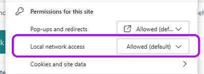

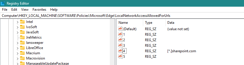

1.) The LNA policy in the Chrome (Edge) browser needs to be configured:
The site permissions then claim 'lna allowed' (without bothering the user):

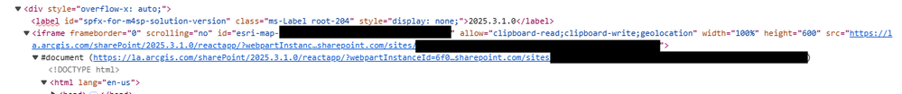

2.) The iframe tag needs to include 'local-network-access' in the allowed list.
This is the current config (2025.3.1.0):
<iframe frameborder="0" scrolling="no" id="esri-map-123" allow="clipboard-read;clipboard-write;geolocation" width="100%" height="600" src="https://la.arcgis.com/sharePoint/2025.3.1.0/reactapp/?webpartInstanceId=123&amp;isVisitor=1&amp;3d=0&amp;locale=en-us&amp;parentOrigin=abc"></iframe>

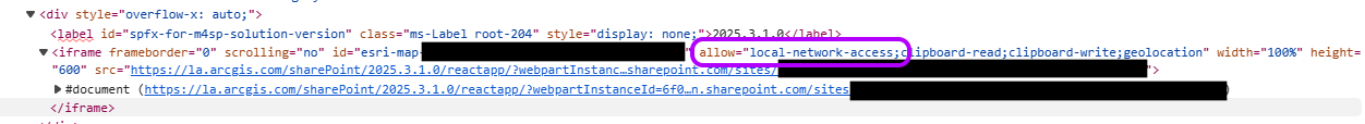

WetterskipFryslan
Alright, sounds good. Page still looks identical though?
Anyway, our SharePoint admin implemented the April update and I can indeed see the lna tag in the iframe's allow list so our pages are now working from within the local domain as well.

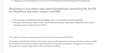

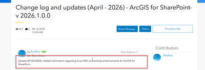

I had updated the blog two weeks ago. Please see the screenshots below:
 Please let me know if you are able to see the note at the top and the newly added section at the bottom of the page. If you don't see it, please try clearing your browser cache and try once again.
I am glad we were able to resolve the issue in the April 2026 release of ArcGIS for SharePoint.
