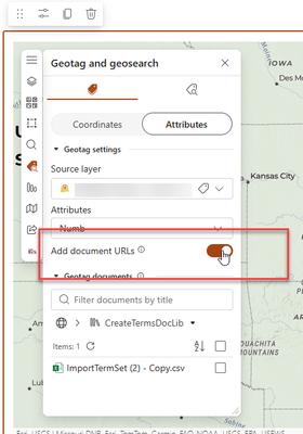

1. Were the links showing up in the popup before the 2025.3 release?
2. Are you tagging documents to a hosted feature layer where you have "edit" permissions?
3. Could you also check if the toggle switch for "Add document URLs" is enabled or turned on?

BradHarshman
Hey Raaj! Thanks for the quick reply.
Yes - But I had the "Add document URLs" enabled then and I think I was playing with a hosted FS.
No - I'm attempting to use a registered Feature Service from our Enterprise. Yes - I have edit permissions.
No - I did not have it enabled. I'm hoping I don't have to have it enabled for the program to retrieve geotagged documents.

Hello @BradHarshman --
Thanks for your response and your kind words. I really appreciate it!
The "Save links to ArcGIS" can only work with hosted feature layers or hosted feature services. SharePoint needs to communicate with ArcGIS in order to create a column to store the geotagged document links and hence this feature (Save links to ArcGIS) can only work with hosted feature layers or services.
