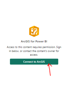

We are currently facing an issue with logging in to access a map in our published Power BI dashboard, which is powered by ArcGIS for Power BI. Up until last week, everything was working fine. However, it seems that the latest update to ArcGIS for Power BI might have caused connection issues.
When users of the published dashboard attempt to sign in to access the map in enterprise mode, clicking the button does not initiate any action.

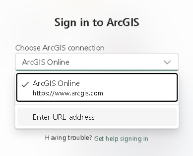

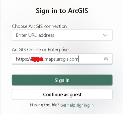

Hi there to log in you must choose the URL option
In the next screen enter your organisation account URL even if it is AGOL

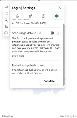

After signing with the credentials the settings to validate (scrooll down)

SarahGaffney
I finally got it to work - the URL is now case sensitive, it was not before. Copying and pasting the url from the address bar resulted in as issue, but adding a capital at the beginning of the company name worked for me
