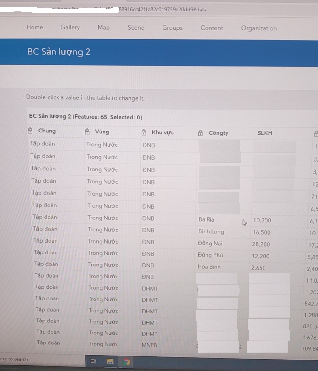

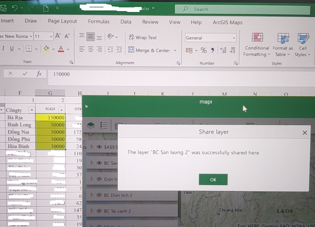

I has share data from excel to portal for arcgis. After, i update a share layer successfully but it not update on portal for arcgis.

I only edit data to the spreadsheet and didn't make any schema update.

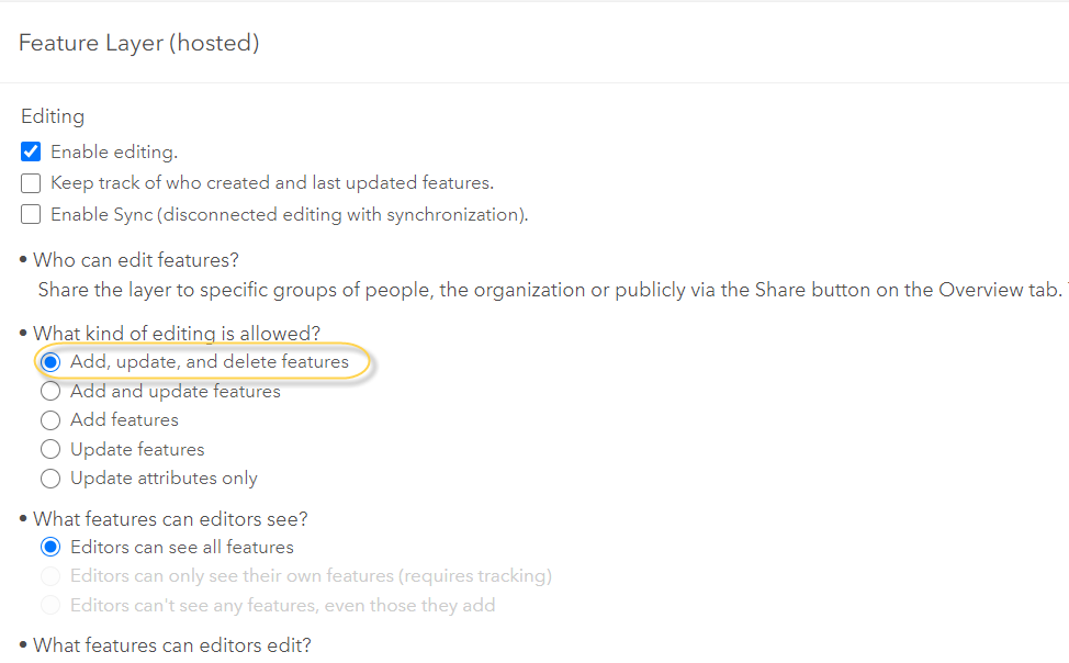

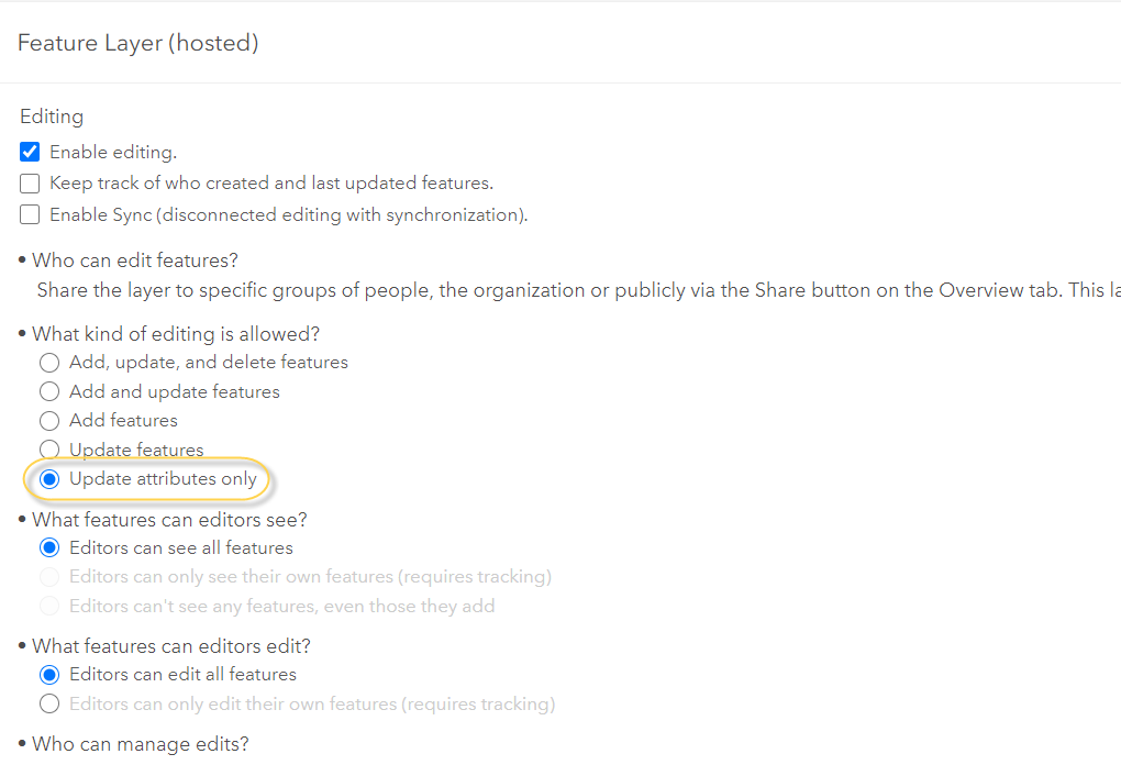

Everything is still updated normally until I changed the setting to "Update properties only", the update fails.
after that, I changed back to the settings "Add, update, and delete features" but still can't update.
