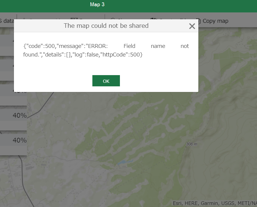

I using ArcGIS Maps for Office 2020.1.2 and ArcGIS Enterprise 10.8.1 (Portal resource for ArcGIS 2020.1.2)
But i can't shared map to ArcGIS
error: the map could not be share
message error: field name not found
code: 50012-11-2020 4-33-47 PM.png12-11-2020 4-33-47 PM.png

Hello there,
   My apologies for not getting back to you sooner! Typically, we see this error when a column name in the excel dataset contains an illegal character. Please go through all of your column names and make sure that no improper character exist. Additionally, please try to publish the file I have attached to this post. This is some sample data that should publish without issues.
